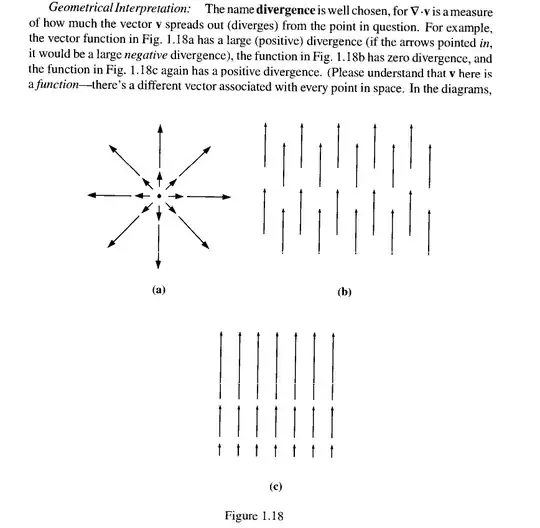

Let's begin with some context. I was reading Griffiths's introduction to electrodynamics.
In this image he explains that geometrical interpretation of the divergence is how much a vector
V spreads out from a point.
This makes sense given all the content one can find online in order to understand visually the divergence.

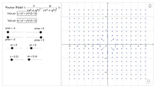

So the problem arises when one tries to understand conceptually (or visually) the fact that $$ \nabla\cdot\frac{\hat{r}}{r^2} = 0, \qquad r\neq 0. $$ I've done the calculation where:
$$\nabla \cdot \frac{\hat{r}}{r^2}=\frac{1}{r^2}\frac{\partial}{\partial r}(r^2\frac{1}{r^2})=\frac{1}{r^2}\frac{\partial}{\partial r}(1)=0.$$
That's fine but I find it impossible to understand it visually. Take for example this picture.
plot of the vector field <span class=$ \vec{r}/r^3 = 0 $ " />
Having in mind the intuitive explanation of the divergence, like the one showed in the links, is easy to see that the flow through a small region in the image above, not containing the origin, is not equal to zero. Furthermore, it is obvious that the divergence is not zero because it doesn't look anything like the next image whose divergence is zero.

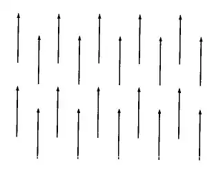

field with zero divergence
(In the image above the vector field isn't changing in space.)

It the question it is said:
"[it] is easy to see that the flow through a small region in the image above, not containing the origin, is not equal to zero"
but if you look at the diagram, what you see, for any region not containing the origin, is field lines coming in from one side of the chosen region and going out the other side. And if you count the number of lines coming in then it is equal to the number going out. That is the property of zero divergence. The very fact that one can draw continuous field lines, not starting or stopping anywhere but just going on, is itself also the property of zero divergence!
Once you have a charge in your region then there can be field lines starting or stopping on that charge, and then you have non-zero divergence.
Andrew Steane
  • 65,285
You need to be careful when calculating the divergence in this case. In particular, notice that the function is undefined or infinite at the origin.
If you calculate the divergence in any area not containing the origin you should be able to convince yourself visually that there is an equal number of field lines entering a region as there are exiting.
If you calculate the divergence in an area which contains the origin, then if you switch the integral to a dot product over the surface via Stokes’s theorem you will get a finite value. If you don’t make this switch you will get zero, but only because you have actually ignored the origin.
A nice way of capturing this property is to say that the divergence is a delta function, which Griffiths does later on.
