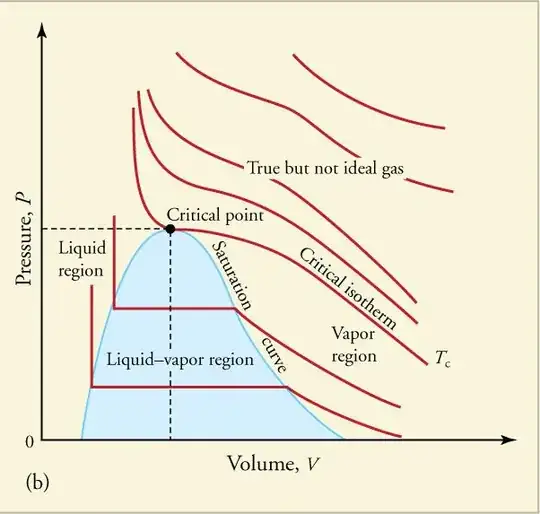

A gas to liquid transition involves latent heat and is hence a first-order transition (apart from the critical point where transition happens with no coexistence).
The isotherms for this transition are shown below:
(image from Lumen Learning | Physics | Phase Changes)
On the liquid side, the isotherms are very steep - that means that the "phase" is purely liquid because this is nearly incompressible. The physical meaning attached to the flat isotherms is then that it's not all liquid, but there is still gas in there. As you reduce the volume, you are essentially only acting on the gas: the gas takes the volume of the container, so you are squeezing the gas, while the part that has condensed to liquid now occupies a smaller volume and is hence not "pushing" onto the walls. The increase of the gas pressure and the decrease of particles that contribute to it (because now in the liquid phase) cancel out. The pressure is hence constant and is equal to the saturation pressure.

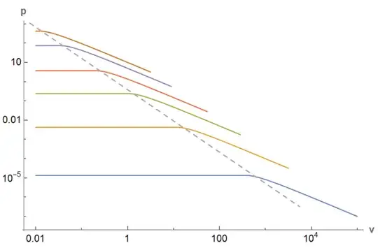

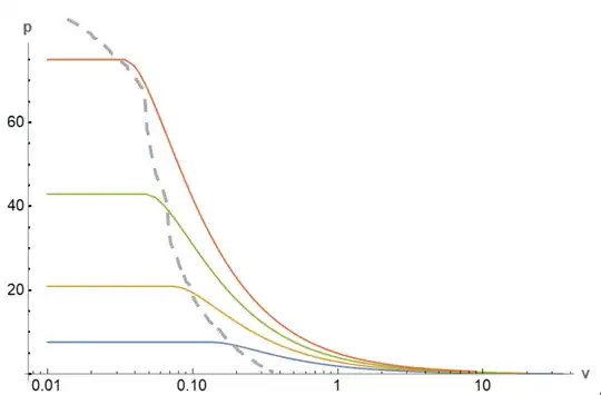

Bose-Einstein Condensation is a second-order (or continuous) transition, so the argument about latent heat does not apply. If you plot the isotherms, however, it is possible to discern a region of flat lines which is reminiscent of the gas-liquid transition above.
The plots below (linear-log, and log-log) are just for qualitative display. The units are at random. I drew the "region" with the dashed grey line.
But for a BEC you always have a co-existence of condensed and non-condensed (thermals) atoms, which also becomes a pure BEC at $T=0$. This "co-existence" though is not comparable to the gas-liquid transition, as there is no latent heat involved. It is purely driven by quantum statistics.
