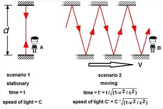

Einstein states: The light speed $c$ does not depend on the observer. Let's take this fact and consider the following two scenarios. In both cases the distance between the upper and lower mirror is $d$.
Observer A is stationary. Hence, the light travels the distance $s=2d$ in a single "round trip".
Observer B moves. However, now the light travels along the hypothenuse of a triangle. Using Pythagoras, we know that the travelled path is longer than in the stationary case. Doing the math you get the result shown in the picture.
If there is no information about the past available, we are unable to tell who is moving and who is at rest1. Hence, the two observers disagree about the reading on their watches: If there are several event, they might disagree which event came first, or whether two events happened simultaneously (=at the same time). This difficulty sits at the very heart of relativity theory, and one can understand why physicists had such a hard time accepting it in around 1905. However, since the two observers never meet again, it is impossible to decide who is wrong and who is right. Also note, the situation changes in the "twin paradox", because accelerations are involved. If one of two twins travels to mars and back, he/she experiences an acceleration. This acceleration breaks the symmetry. After returning to earth the astronaut is the "younger twin".
