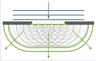

Huygens principle states that the propagation is due to the generation of spherical waves, which will generate spherical waves in the next step of propagation. [Picture taken from wiki] enter image description here
In the image we see that the center of the "hole" generates a "flat" wave. The diffraction is evident only in at the edges.
In order to capture the behaviour of the "central part" of a wavefront we use approximation and omit the edges to a certain extend. In the upper picture we might describe the central part as a plane wave. If instead we use spherical mirrors to generate a propagating wave, we end up with the Gaussian beam $$ E \propto exp\left( - \frac{r^2}{w_0^2 (1 + (z/z_R)^2)} \right) $$ If we include the quadratic phase correction for the wavefront and the Gouy phase the approximation improves. However, the Gaussian beam is always an approximation obtained by omitting the edges of the wave (in deriving it, we use the paraxial Helmholz equation).

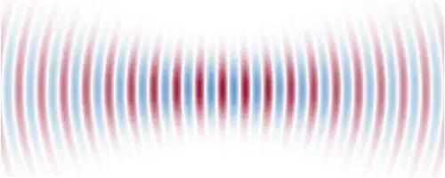

A better description is light as a wave. To get the true beam, you must solve the classical Maxwell's equations with a boundary condition. The optical cavity of a laser must have curved mirrors to be stable. The wave solution for a cavity bounded by spherical mirrors is a Gaussian Beam. Wavefronts are spherical. "Rays" are not quite straight, but follow hyperbolic paths. The beam cross section is Gaussian. The intensity is maximum at the beam axis and falls off smoothly away from the axis.
Image from https://www.rp-photonics.com/gaussian_beams.html

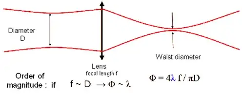

This is enough to tell you that a small diameter beam will have a large divergence. If you focus a beam to a small spot, it will have a very small waist. Therefore it must have a large divergence angle.
The image is from optique-ingenieur
