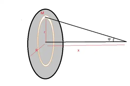

Let's break the disc into small rings,enter image description here
Here the mass in the disc is at a same distance $\sqrt{x^2+r^2}$ from the axis point A.
So, potential $$\mathrm dE=-\frac{G\,\mathrm dm}{\sqrt{x^2+r^2}}$$
Where $\mathrm dm$= mass of the ring. So, $$\mathrm dm=2\pi r\,\mathrm dr \times \frac M{\pi R^2}$$
Also $r=x\tan\phi$, so $\mathrm dr=x\sec^2\phi\,\mathrm d\phi$
So, the potential is $$\mathrm dP=-\frac{GM2\pi x\tan\phi x\sec^2\phi\,\mathrm d\phi}{\left(x\sqrt{1+\tan^2\phi}\right)\times\pi R^2}=-\frac{2 GMx}{R^2}\times\tan\phi\sec\phi\,\mathrm d\phi$$
So, $$P=-\dfrac{2GMx}{R^2}\times\int\limits_0^{\tan^{-1}R/x} \tan\phi\sec\phi\,\mathrm d\phi$$ You can integrate it on your own.
You can proceed on similar basis for electric field. But before integrating you'll have to take components of field along axis and perpendicular because it's a vector and cannot be added directly.
You'll get field integrand as $$\mathrm dE_x=\frac{2GM}{R^2}\times \int\limits_0^{\tan^{-1}R/x}\frac{\tan\phi\sec\phi}{\sec^2\phi}\,\mathrm d\phi$$
Whereas along $Y$ you'll get no field by symmetric argument.
