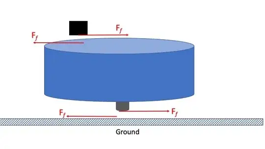

So, there should be some force acting radially out to cause static friction acting radially in, but even in that case sum of forces acting in radial direction is zero since static friction balances outer force trying to move us. If so, there is no net force acting radially in to allow rotation. Where have I gone wrong?
There is a force acting radially out. But as can be seen in the free body diagrams below of an object and the merry-go-round, it is the friction force the object exerts on the merry-go-round in opposition to the friction force (centripetal force) that the merry-go-round exerts on the object, as an action-reaction pair at the surface per Newton's third law. These equal and opposite forces are the reason there is no relative motion between the block and merry-go-round.
However, as shown in the FBD of the block, the friction force the merry-go-round exerts on the object is the only external horizontal force acting on the object and is analogous to the example given in the answer by @BioPhycisist. It is this net force on the object that causes it to accelerate radially inward giving it circular motion.
