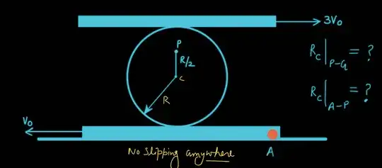

I was solving a question where a disc was placed between two plates which were given velocities $V1$ and $V2$ and was asked to find radius of curvature at a point P on the disc. It was mentioned that there was no slipping.
Here A is a point on the lower plate and G represents the ground '-' represents with respect to
My teacher found velocity of centre of mass using the pure rolling condition and used instantaneous axis of rotation, considering it to be a line through the centre of the disc perpendicular to the plane. {He calculated velocity}
I have always had this thought that if any point on a rolling body has $v=0$ then it must be on the instantaneous axis of rotation. Is this true and if yes then would'nt there be another axis of rotation, one which passed throught the plane of disc touching the point of contacts with plates (where $v=0$ due to no slipping). But the answer with this approach is not matching with this approach.
Where am i wrong?

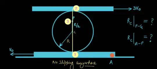

There is a theorem of kinematics that when two bodies are in contact their relative center of rotation has to be along the contact normal (even with slipping). And when three bodies are in contact the center of rotation of one body is always on the line connecting the relative centers of rotations with the other bodies.
In this case, the relative center of rotation are at (1) and (2) below, and so the axis of rotation of the disk must be on the line connecting them. You will find point (3) the axis of rotation does so.
fig1
