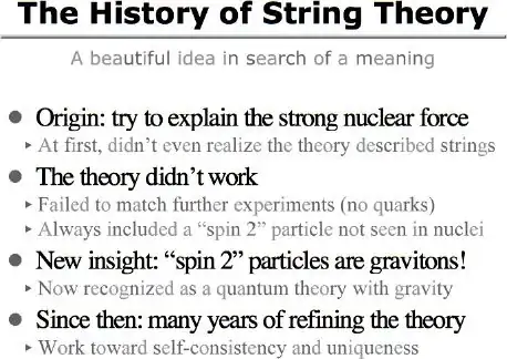

As can be seen in the very summit history above, spin 2 particles were contained in the attempt to describe the strong interaction. Quarks and the chromodynamic field were not known yet. The strong interaction between nucleons and mesons (the last of which were used in an even earlier attempt to describe the strong force) was considered as a bundle of strings existing between the particles that take part in a strong-force-mediated reaction. As such, the model could explain the force increasing with distance.
Now, gravitons carry spin-2. The chromodynamic gluon field has spin-1. This field wasn't known back then. Was the string bundle (quark confining flux tubes) somehow associated with spin-2 particles? I found this (in this question):
These higher spins states also have higher masses. Amazingly, when all the possible states are plotted in a spin-versus-mass-squared graph, the result is a beautiful set of straight lines with even spacing between the 2-spin additions. These lovely and highly unexpected lines are called Regge trajectories, and they are the true origins of string theory.
Spin-2 is mentioned here. Is this how the strong-string-bundle in the picture used is related to spin-2? The spin-1 colored gluon field was not known at the time, so spin-2 could be involved, but usually, spin-2 is related to quantum gravity. Tensor particles are related to spacetime distortions. How do they emerge in the early string description of the strong force?

Is this how the strong-string bundle ... is related to spin-2?
Essentially, the early models of the strong force, before QCD, were dual resonance models. It's here where Veneziano discovered a formula for the amplitude which had certain symmetries (and hence the dual in the dual model), called the Veneziano amplitude. It was later shown by Susskind & Nambu that this amplitude arose from quantising the bosonic string.
However, on quantising a bosonic string, we find in its low energy spectrum a tachyon (a faster than light speed particle), and it's for this reason, amongst others that the model was abandoned for the more fertile pastures of QCD, especially after t'Hooft showed that quantised Yang-Mills theories were renormalisable.
But, it was also discovered that the low-energy spectrum also contaimed a spin-2 particle. It was Schwartz that suggested this particle be identified with the graviton and to investigate the theory as a theory of quantum gravity.
