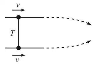

The necessity of this result can be seen in a much simpler setup. Consider a stretchable string connecting two equal masses, which has a constant tension $T$ in its rest frame. If the masses start off at rest, they will come together and collide due to the string.
Now consider the reference frame where the masses are initially moving with velocity $v$ to the right. As the string accelerates the masses towards each other, the rightward velocity $v_x$ must stay the same, so the speed goes up, and the Lorentz factor $\gamma$ increases. But the rightward momentum is $p_x = \gamma m v_x$, which means $p_x$ must increase, which means there must be a force in the rightward direction. This force must be applied by the string itself, meaning that the force it applies is not parallel to itself.
(There is a second subtlety in this particular setup: if the string is exerting rightward forces on both particles, doesn't that violate conservation of momentum? No, because the string itself carries rightward momentum; it must carry an energy per length of $T$, which means it has a mass per length of $T/c^2$. As the string's length decreases, it gives up its momentum. But this is irrelevant to OP's question, since OP's stick has constant length.)
