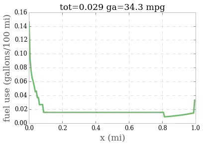

Since some of the fuel loss we incur is some constant power $P_0$ for having our car on in our model, we could benefit from essentially the same design. Use gravity to reduce the time it takes for us to go from A to B, and assist in coming up to nearly optimal speed, and we might be able to save on some fuel.
In particular, as we suggested a moment ago, the real trick would be to try to mitigate the large fuel cost of our initial acceleration in the beginning. If only we could use a slopping road to speed us up, then just maintain constant nearly optimal speed for most of the trajectory and then slope up at the end, wherein again gravity would help us brake without having to apply it ourselves.
In fact, let's look at the integrated acceleration of our optimal path as a function of distance:
Integrated acceleration of Flat Terrain Trajectory
Here I have even divided through by $g$, so that this is a path on which our car would feel the same acceleration profile it takes in the optimal trajectory for the flat terrain case.

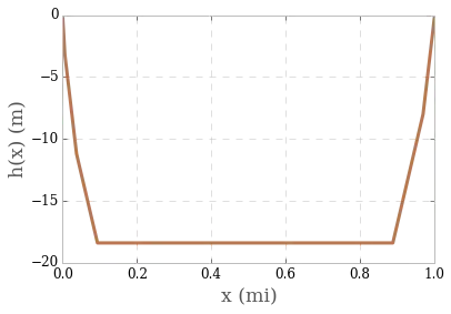

Our truly optimal road should look qualitatively like this. We will use an initial downward slope to speed the car up to nearly optimal speed, then we will maintain that speed for most of the trajectory. When we get to the end, we'll use the upward slope to help slow the car down. Notice that our integrated acceleration doesn't quite make it back up to $h=0$. This is due to our frictional losses, and it will mean if we try to use a downward dip, we'll have to throw in some acceleration in the end in order to make it back up.
In our flat trajectory, we didn't need to use extra fuel at the end, since we applied our brakes. Here we'll have to give it some oomph at the end, but it should only take some fraction of the fuel it took in the flat case to get us up to speed. In the language of this hill thing, the downward slope gets us down to speed, and while its true we won't come all the way back up, we will certainly make it some or most of the way back up the final hill.
Let's now actually compute the optimal path for the road, by extending our dynamical program.
Optimal Hill Design
We'll use the same numeric technique we used before, but with a new control variable $h(x)$, the height of our road as a function of distance. We have to modify our dynamical constraint, this time we will have
$$ \dot v = a(v,u,h) = u - \frac{A}{m} (v>0) - \frac{B}{m} v - \frac{C}{m} v^2 - g \frac{dh}{dx} $$ where we have added another term to our acceleration given by the shape of our road. Our fuel use will stay the same, as we only incur a fuel cost for using our accelerator. But now we will need to solve the larger dynamic program:
$$ C(x_i,v_i,h_i) = \min \left\{ \frac{r(v,u,h) }{v} \Delta x + C(x_{i+1}, v_{i+1}, h_{i+1}) \right\} $$ Where we will impose our dynamical constraints in much the same way above, but now our minimization will be a two dimensional minimization over candidate velocities and heights. In either case, the program still runs, just takes some more time and we find for our optimal road:
Optimal Road
Which honestly looks pretty similar to what our intuition suggested. As before, we can look at the optimal $v(x), u(x)$:
Hill Optimal velocity and accelerator
Where our velocity profile looks pretty similar. Our accelerator shows some goofy behavior, but overall has the kinds of trends we expected. We let the car more or less glide down the hill, then maintain a constant nearly optimal speed, and then let the hill slow us down but add some juice at the end.
The real test will be to compute the fuel use in this case:
Hill Fuel Use
and TADA, we use slightly less fuel, 0.027 gallons corresponding to an average efficiency of 37.6 mpg if we allow the road to find its own optimal configuration.
This is 0.002 gallons less than the flat terrain case, or about half a cent's worth of gas at current prices. This saving should also be more or less independent of the distance we are hoping to drive, as in either case we have a long stretch of time where we are travelling at nearly optimal speed, the difference was just in how we try to mitigate the initial speed up from our flat terrain case.

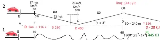

"Is there any hilly road on which a better mileage can be achieved?"
The answer is: YES.
Let's just use three simple reasonable assumptions: 1) There is rolling friction 2) There is air friction which increases with speed 3) In the graph of power vs gas consumption, there is a peak (a maximum)
note: (power)/(gas/time) has the same units as energy/gas. If there was no air friction and rolling friction was a constant, we'd want to run the engine at this peak until we could just coast the rest. However, because there is air friction, it may actually be better for gas mileage to run below this power output. That is the trade off on the flat road.
An appropriately shaped hill lets us beat this trade off, because we can go into a gear so that we go very slow essentially giving all our engine power into gravitational energy. We just coast to the hill (or after the hill), with the engine off.
Viewed this way, the answer is obvious, since we are essentially using the hill as a gravitational battery. It lets us beat the flat straight away, because we can give that energy back at 100% efficiency compared to the < 100% efficiency of the motor in the "air friction with speed" vs "power output vs gas consumption" tradeoff we are forced into with the flat road.
The best road I believe would then be just enough slope to allow rolling against friction all the way until a steep hill right at the end.
EDIT:
Some of the comments and other answers to this question are quite bizarre. To make it clear, I am not claiming that all hilly roads are better. The question asked "Is there any hilly road on which a better mileage can be achieved?" The answer is YES. Nor am I claiming that this depends only on the road, as it clearly depends on how the driver decides to run the engine for speeds along the route. Again, the question seems clear on this, as it says to consider the car "operated by a perfect driver with knowledge of the route". So I am not sure where the confusion is coming from. So I am extending discussion here, in hopes to clear that confusion up.
There are three places where stored or mechanical energy is lost to heat: the engine performance curve, the rolling friction of the tires on the road, and the air friction. The tire friction is to good approximation a constant, while the air friction increases with speed. Putting this all together:
the total mechanical energy used to get from A to B: $E = mgh|_A^B + \int_A^B (F_{air} + F_{rolling}) ds$
Since A and B are at the same elevation in this problem, the gravitational potential energy terms sum to zero and are the same for both routes. To good approximation the rolling friction is a constant, then if the length of the road is L: $E = L F_{rolling}+ \int_A^B F_{air}(v) \ ds$
So the rolling friction is the same between the two routes. The only thing left then is the engine performance curve (the efficiency at which we can get the mechanical energy from the gas) and the air friction. The answers neglecting the engine performance curves, or air friction, are thus neglecting the real difference between these routes. I hope I made that abundantly clear now.
It is easy to see that if the engine performance curve was flat (a constant), then on a flat road, we'd want to go very slow (the limit v->0 is the best driving strategy for gas mileage in this unrealistic case). However, in realistic cases (and as I took as one of my three assumptions in my answer above) the engine performance curve will have a peak. There is now a trade off between how far off peak performance we run the engine, and how much mechanical energy we waste on air friction. The details of solving this require detailed knowledge of the engine performance curve, but the general result that there is a trade off is clear regardless. The issue is that on a flat road: the engine can only generate mechanical energy in the form of kinetic energy, and kinetic energy in turn causes more energy loss in air friction.
Now consider the case where the road slopes just enough to a hill at the end, that we can just coast down to the hill, and only need to use the engine to get up the hill. (Or, alternatively, as other poster suggested, a hill at the start, and then coast the rest of the way.) When running the engine now, we can generate mechanical energy in the form of kinetic energy and gravitational energy. So a hill allows us to run the engine closer to its peak performance, since we can put the engine output into gravitational energy (which has no loss over the trip) as opposed to just kinetic energy (which we get losses in air friction).

...two roads of the same length. One road is flat, the other road goes up and down some hills. Will an automobile always get the best mileage driving between the two towns on the flat road versus the hilly one..?
The question
  1. two roads (between two towns A, B) with a different profile cannot be of same length
  1. The flat road (1) is shorter, therefore the ratio fuel consumption/miles will be always worse, but also the absolute consumption can be greater in some circumstances
Edit:
Well, there is comment to other answer from OP that state "the flat road must be curved because it has the same length as the hilly road and connects the same endpoints. Neither road is straight." – Vaimsu
I regret I had not noticed this comment, this makes the case for the flat road even more hopeless, especially if there are sharp bends.
  1. even if we overlook that ambiguity in the original question, it is still impossible to give an adequate answer (and alemi's considerable effort is somewhat wasted) since the question is too vague, does not specify any parameter and does not specify if it is purely academical problem or if it refers to real life: for example
....if operated by a perfect driver
a perfect driver knows that it is not lawful and not advisable to run downhill in neutral or, even worse, after switching off the engine, especially if there are sharp bends in the route. Is the driver in our answer allowed to behave in such an irresponsible manner? if he is, to what extent? should we consider the ordinary behaviour/speed at which we travel everyday or is it a sort of Mobil Economy Run,... etc.
Luckily,...
Will an automobile always get the best mileage driving between the two towns on the flat road?
... the answer is an unequivocal "no, not always"
The answer
  • If the question is an abstract one and we do not consider cars but a ball or a rollercoaster, the answer is simple: the flatter the road the worst the performance, as you can see in this video.
And here you can learn how with calculus of variations one can find the best-performing curve[s], which are the ones they use in rollercoasters:
on a frictionless mag-lev track a car can go for a quite long way without any fuel consumption at all.
  • If the question is referring to real, responsible driving the answer is still, doubtlessly, : NO, not always:
Supposing the driver is in no hurry and drives normally but with prudence (say at 60 Km/h) on both roads, and the down/up-hill road has a gentle slope, there are no hairpin bends, etc..., then the absolute consumption of fuel on the flat road can be indeed greater, ([Edit: obsolete] and the relative consumption, the ratio fuel/miles definitely a lot worse) When riding downhill, a safe trick which even a perfect driver can use, is to step on the clutch: one does save fuel but, at the same time, facing a curve or any other emergency by releasing it one gets an immediate response.
Update
My original answer considered a flat road shorter than the hilly one, but if the roads have the same length, the second route is almost always more convenient, actually it is really hard to find a case in which it is not. The accepted answer was correct and maybe even too hesitant.
Let's consider a realistic case of a road with a slope of 5%, and the MIT example
No complex calcs are needed, and we do not have to accomodate the roads to our wishes, what matters here is only the difference between the two routes:
both cars can accelerate from 0 to 60 Km/h starting from A and travel any distance to B, then
  • travel the distance BD equal in length and different in profile.
  • rolling friction is practically the same and
  • air drag at 17 m/s is the same: what matters here then is only the difference in air drag when the car (2) accelerates downhill. From the MIT formula (quoted by Tom Heinzl): $$[1/2(0.33)(2.66m^2*330Km)(1.2kg/m^3)*(27.7m/s)^2 = 133MJ]/330,000$$ we know that, for that car (m = 1800 Kg), the energy lost to air resistance is: $400J/m$ at 28 m/s, at 60 it's (400*.6^2) roughly = 114, and at 80 it's (400*.8^2) = 260; the difference is (260-144) = 116 J/m, since the slope is 5% and the speed increase is $\Delta v = 11 m/s$ BD is rougly 240 m,
  • the total loss is **- 28* kJ. On the other hand the increase of energy due to the drop in altitude is $1/2 1800* (28^2-17^2)$
  • the gain from PE is + 455 kJ: a small fraction of that will be spent to compensate the increased air resistance and restore the final speed to 60 Km/h, another tiny fraction might be accounted for an eventual increase of rolling friction, keeping the engine running at min, or other factors (like occasional braking, but also car (1) must occasionally step on the brakes), but the balance is surely positive.
    Since we are told that the road is straigth and the speed of 100 Km/h is quite safe, there is no need to brake. It is not necessary, also, to switch off the engine, to shift into neutral or to disengage the clutch, since an authomatic transmission will adapt itself, but also an old car with overdrive will burn almost no fuel at 100 km/h, and then, lastly, modern cars make use of regenerative braking. In conclusion:
Allowing for some eventual (even huge) imprecisions in my calcs, the conclusion is unequivocal: except for particularly high *speeds, the flat road will get the worst mileage and the car (2) will accumulate hundred of KJ's energy at every drop in altitude. Therefore the correct answer seems : NO, almost never!
*Considering a cruising speed of 28 and a peak of 39m/s at the bottom, the energy lost to air drag doubles,but remains well below the energy gain.
