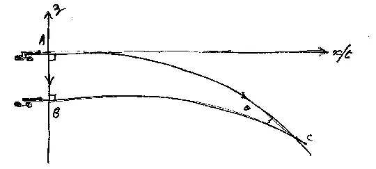

Anyway you can "see" spacetime curvature in the spacetime diagram below. Time runs along the horizontal axis, height runs along the vertical axis. Ignoring the physical extension of the cannonball and friction etc...
  • A cannonball is fired from a cannon at A. It moved along a geodesic (straight line in curved space) and drops to C.
  • At the same time a cannon ball is dropped from A to B along another geodesic (straight line in curved space).
  • When the cannon ball arrives at B, a 3rd cannon ball is fired at high speed along another geodesic (straight line in spacetime) and miraculously strikes the first cannonball at C.
The trajectory of the cannonballs forms a warped triangle whose interior angles sum to greater than 180 degrees, confirming that spacetime is curved in the presence of gravity.
