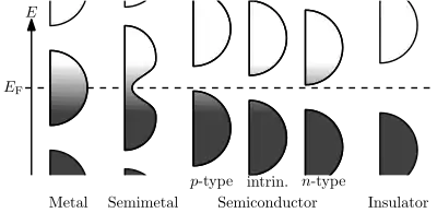

Look at the picture below. The half-circular shapes (I do not see why they are drawn in this way though) represent bands of available electron energies. is represents the electron energy. White means non-occupied while black means totally occupied. For a metal, you can see clearly that electrons can move higher to states of energies within the band they occupy. So without jumping a gap. For semi-conductors, you can see that a part of the gaps with energies above the Fermi energy is filled (except for the p-type). For an insulator, all electrons occupy states with an energy below the energies that are "present" in the band above it. The electrons have to be excited to very high energies before they can jump the gap.
Note that the Fermi energy can lie between bands.

  5. Look at the picture above.
