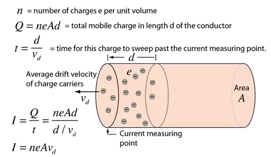

Electrons and atoms are within the realm of quantum mechanics, and quantum mechanical models are needed to really describe correctly what is happening. This means that the motion you envisage is a macroscopic end effect, and is illustrated here:
current

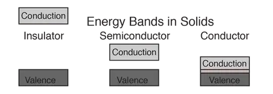

The correct quantum mechanical models use the band theory of solids
bandtheory
It is the electrons in the conduction band that are the ones acting as the first image. They are shared with the whole lattice of the solid and act as "free" when a potential difference is applied.
