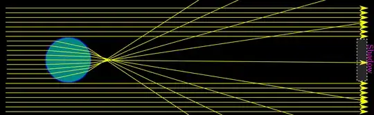

This is just to add an illustration to noah's and Ralf Kleberhoff's answers which correctly point out that refraction is the main reason.
Illustration of refraction-shadow
Note that although most of the light rays do make it through the water drop, most of them do not continue on the path with the rest of the light bundle, but end up somewhere else. As a result, right behind the drop, the light intensity is much lower than it would be without the drop, whereas around this shadow it'll actually be slightly higher.
