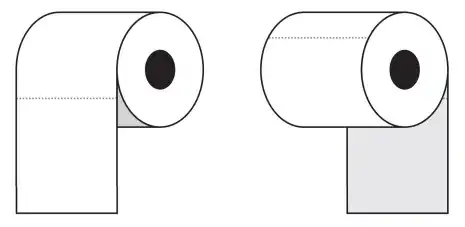

There are two ways to orient the toilet paper: "over" (left image), "under" (right image).
orientation
Each has it's pros and cons. For some reason, it's always easier to tear off the paper in the "over" orientation even though we apply the same force thus same torque. I assume these rolls are almost perfect cylinders (no excess of mass in one orientation compared to other) thus they have the same moment of inertia (degree of difficulty on changing the angular velocity of the object around the longitudinal axis of the roll) therefore both ways should be equivalently easy but it's not.

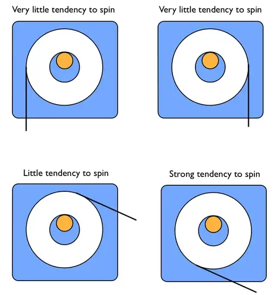

Here's a graphic summary:
TP experiment results summary
These results seem mostly consistent with the theory described above, and they suggest a refinement. When yanking at an angle in the "over" configuration, the straight segment of the toilet paper is tangent to the upper part of the roll before the yank, close to the point where the hole is resting on the axle. When yanking at an angle in the "under" configuration, the straight segment of the toilet paper is tangent to the lower part of the roll before the yank, far from the point where the hole is resting on the axle. As a result of the longer lever-arm, yanking at an angle in the "under" configuration applies a larger torque (hence a stronger tendency to spin the roll) compared to yanking at an angle in the "over" configuration, as observed in the experiment.

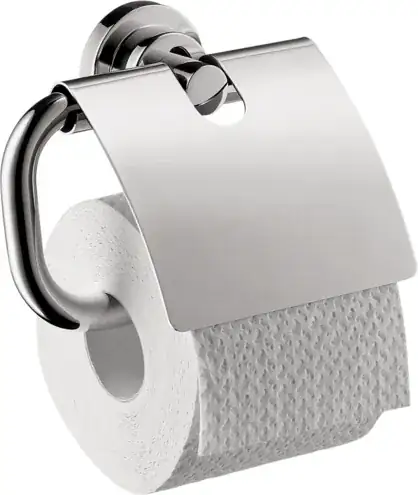

What is often missed in such debates, is that a commercial toilet paper suspension usually looks like in the image below. The metal lid on the top actually serves to prevent the roll from rotating, while one is tearing the paper.
In absence of such a lid, one has to block the roll either by one's hand/fingures (typically in the over orientation) or against the wall (more suitable for the under orientation).
