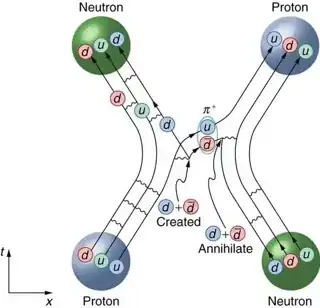

Gluons are exchanged between quarks of the same proton or neutron, thus keeping that proton or neutron together. But are gluons exchanged between different protons and neutrons? If so, is this what keeps them bound together in a nucleus? How does this relate to the image below? Are the black lines representative of gluons?
pionexchange
How does this relate to the image I've found?
The black line represent quarks, the wiggly ones gluons.
So are gluons what mediate pion exchange, which is in turn what binds protons and neutrons with the strong nuclear force?

It is only neutral in color quark combinations that could range as virtual exchange particles outside the bag, creating a spill over force, as with the diagram above. A gluon is always colored and has to remain within the nucleon, within the hadron bag, there is a probability to create a virtual color neutral combination, which can then be the carrier of a spill over force that can interact with another color neutral nucleus. The pion is the lightest such combination.
Actually the pion as an exchange between nuclei was proposed long before color forces were even imagined, by Yukawa:
The Yukawa interaction was developed to model the strong force between hadrons. A Yukawa interaction is thus used to describe the nuclear force between nucleons mediated by pions
In 1935 he published his theory of mesons, which explained the interaction between protons and neutrons, and was a major influence on research into elementary particles
So gluons mediate the strong color force, pions mediated the strong nuclear force, and the diagram above is one of the possible ways the pions could be created within a nucleus and get out to interact with another nucleus.
