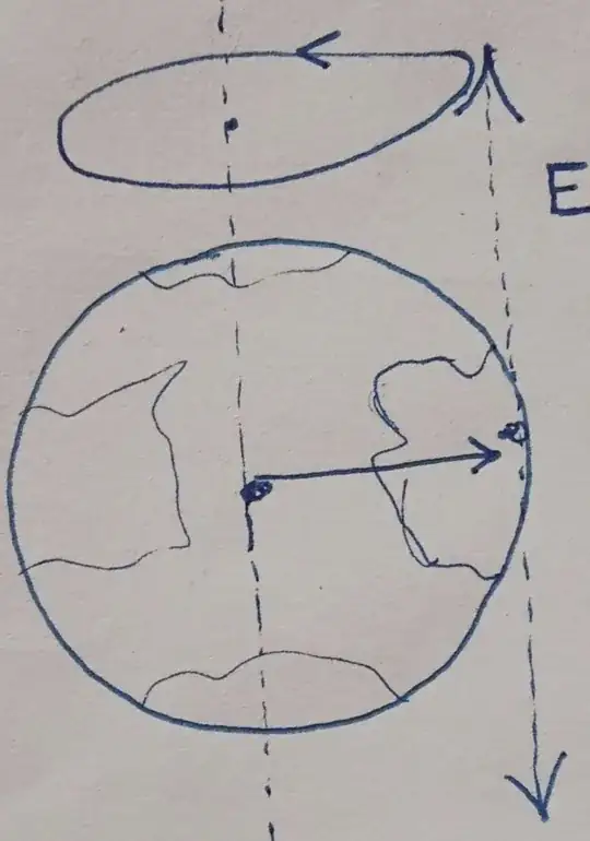

A person on the surface of earth is not in a rotating but a revolving coordinate system, that revolves around the axis of earth ( neglecting rotation around sun) shown as $E$,that goes around the centre of earth.
How do we describe motion in such a revolving frame? What pseudo forces should I add to analyze motion using newton's laws? When I look at my textbook this difference isn't touched upon and perhaps the motion is same as would've been for a purely rotating one.
I'd be glad if someone pointed out , I don't have a teacher to go to.

If the co-ordinates of an object $O$ with mass $m$ are $\vec r(t)$ relative to a rotating co-ordinate system with its origin at the centre of the earth and rotating with the earth, then we know that
$\displaystyle m \frac {d^2 \vec r}{dt^2} = \vec F(\vec r, \dot {\vec r}, t)$
and on the right hand side of these equations of motion we know we need to include fictitious forces such as centrifugal force and Coriolis force, as well as any "real" external forces.
If we now use a revolving co-ordinate system with its origin at a fixed point on the earth's surface, but still rotating with the earth, then the co-ordinates of $O$ in this revolving co-ordinate system are $\vec R((t)$ where
$\vec R(t) = \vec r(t) + \vec c$
Note that there is no time dependence in $\vec c$; we know that $\vec c$ is a constant vector because the origin of the revolving co-ordinate system is fixed on the surface of the earth and its orientaion rotates so that it is always the same as that of the rotating co-ordinate system.
Since $\vec c$ is constant, we have
$\displaystyle m \frac {d^2 \vec R}{dt^2} = m \frac {d^2 \vec r}{dt^2} = \vec F(\vec r, \dot{\vec r},t) = \vec F( \vec R - \vec c, \dot {\vec R}, t)$
so we can see that the equations of motion of $O$ in the revolving co-ordinate system are the same as in the rotating co-ordinate system, as long as we adjust the right hand side to account for the translation of the origin by $\vec c$. One implication of this, for example, is that the magnitude of centrifugal force at the origin of the revolving co-ordinate system is not zero, but is $m|\vec c| \omega^2$.
