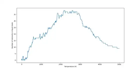

I also thought it might be interesting to plot the total number of elements in the liquid state at a given temperature as a function of temperature:
The first peak corresponds to the temperature range $2161\text{ K} - 2219 \text{ K}$ while the second peak corresponds to $2584\text{ K} - 2627 \text{ K}$.

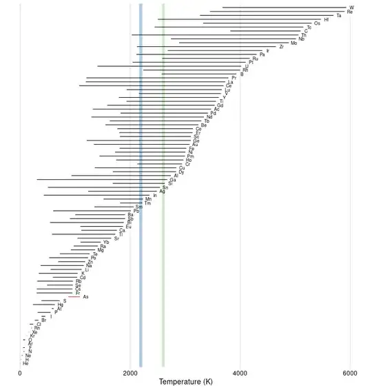

I thought another visualization of the data set might be interesting. Here's the liquid range for each element up to and including uranium, sorted vertically from lowest to highest boiling point. (For consistency with the other answer, I also used mendeleev as the data source.) The colored vertical stripes mark the maxima found by Nihar Karve and Chris H (see the other answer).
This shows that the positions of the maxima are controlled by a few elements that have unusually high melting points for their boiling point: chromium and vanadium for the lower maximum, boron and ruthenium for the upper maximum.
Footnote: In mendeleev's data set, two elements have a melting point greater than their boiling point:
| Name | Symbol | Melting point (K) | Boiling point (K) |
| Neon | Ne | 48.0 | 27.1 |
| Arsenic | As | 1090 | 876 |
I have marked these anomalies by drawing the "liquid range" line for these elements in red instead of black.
For arsenic, the anomaly is because, at 1 atm, arsenic sublimes at $876\ \mathrm{K}$. According to
Gokcen, N.A. The As (Arsenic) system. Bulletin of Alloy Phase Diagrams 10, 11–22 (1989). https://doi.org/10.1007/BF02882166
the lowest pressure at which arsenic can be liquid is $35.8 \pm 0.5\ \mathrm{atm}$ and its melting point is $1090\ \mathrm{K}$ at that pressure. The authors of mendeleev seem to have chosen to record both numbers. I presume the situation is similar for neon.
