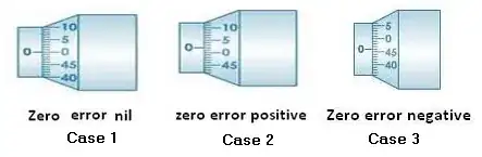

The method that you have used to account for zero error in screw gauge makes no sense for screw gauge zero error.
When the reading on the circular scale across the linear scale is more than zero (or positive), the instrument has a positive zero error as shown in case 1. When the reading of the circular scale across the linear scale is less than zero (or negative), the instrument is said to have a negative zero error, as shown in case 2.
As far as your question is concerned that what would be the zero error if 25 divisions coincide with the zero of the main scale? Will it be a positive error or a negative error? It is positive zero error in this case.
Reference
