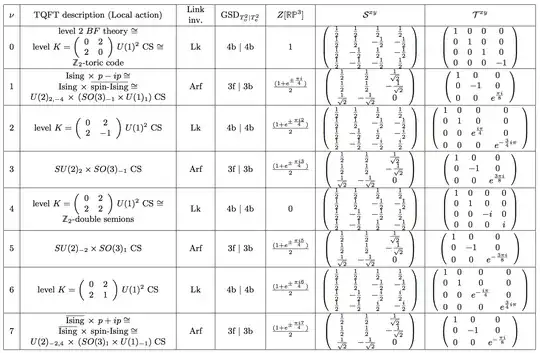

However, if we stack a chiral $p_x+i p_y$ with a anti-chiral $p_x-i p_y$ superconductor, what we obtain is a Topological Superconductor respect to $Z_2$-Ising global symmetry as well as a $Z_2^f$-fermionic parity symmetry. So it is a 2+1D $Z_2 \times Z_2^f$-Topological Superconductor. And indeed the 1+1D edge modes on the boundary of the system have central charge $(c_L,c_R)=(1/2,-1/2)$, thus the chiral central charge $c_L-c_R=0$ (mod 4), which is indeed a non-chiral edge mode and a gappable edge by breaking the $Z_2$-Ising global symmetry with some appropriate interactions.
It turns out that stacking from 1 to 8 layers of such $Z_2 \times Z_2^f$-Topological Superconductor ($p_x+i p_y/p_x-i p_y$), you can get 8 distinct classes (and at most 8, mod 8 classes) of TQFTs. They are labeled by $\nu \in \mathbb{Z}_8$ classes of 2+1D fermionic spin-TQFTs:
There are a list of topological invariant data given above. Such as topological ground state degeneracy (GSD), reduced modular $S^{xy}$ and $T^{xy}$ matrices for anyonic statistics.
The 8-th class is the same as the 0-th class.
More details are here.

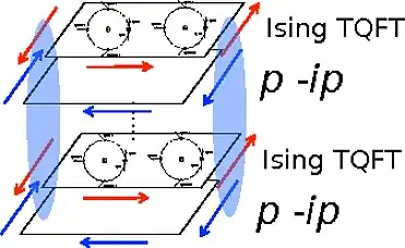

Note added 2: The illustration of stacking $\nu$-layers of (Ising/$\bar{\text{Ising}}$ TQFT or p+ip/p-ip) superconductors:
The winding figures illustrate the 1/2-quntum vortices ($\frac{hc}{2e}$ flux) that traps Majorana-zero mode as a non-Abelian $\sigma$ anyon.
