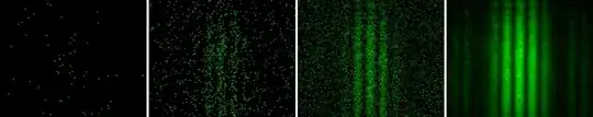

That photons have a footprint of a particle as seen in this experiment
singlepho
Single-photon camera recording of photons from a double slit illuminated by very weak laser light. Left to right: single frame, superposition of 200, 1’000, and 500’000 frames.
Individual photons leave a footprint of a point on the screen, they are not spread all over the space. The probability distribution is given by the $Ψ^*Ψ$, where $Ψ$ is the wavefunction, and the interference pattern is seen when the number of events accumulates.
