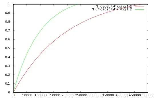

But, if the refrigerator only cycles on at a specific temperature there will be no difference. I wrote a numerical simulation to test this. Here is the plot: enter image description here
The simulation is a simplified, idealized, purely numerical one, hence the lack of units. The Y axis is temperature and the X axis is time. The red curve is the loaded refrigerator and green curve is the unloaded one. For the simulation I made the loaded fridge have double the heat capacity.
Assuming the refrigerator only cycles on when the temp reaches the top of the graph then there is no difference between the two. Although twice as much heat energy must be put into the loaded refrigerator, the simulation shows that it takes exactly twice as long. That is, the average rate of heat flow is identical.
