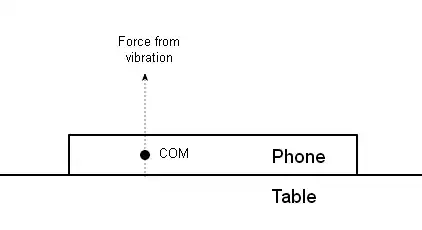

Close, though what you need is not for the phone's centre of mass to be in the centre. You need the force produced by the vibrating element to pass through the centre of mass (and be normal to the surface(.
Phone
In the example I've drawn above, the force produced by the vibration passes through the COM so there is no net torque on the phone and it will rise straight up even though the vibration isn't coming from the centre. If you move the force to the left of the COM it will apply a clockwise torque to the phone. The friction between the right edge of the phone and the table will pull the phone to the right. Likewise, moving the force to the right of the COM will tend to pull the phone to the left.
