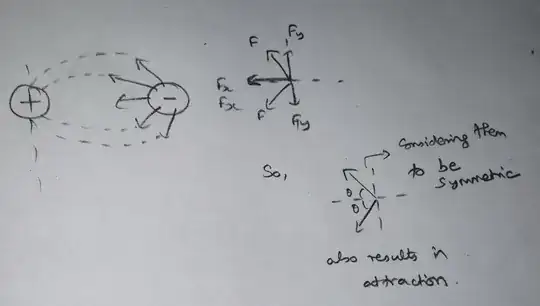

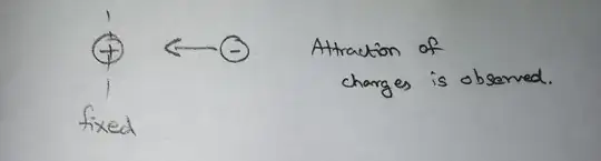

Considering electrostatic force,a part of electromagnetic force,
When a positive point charge (fixed) and a free negative point charge are in surroundings,we observe an attraction between them. Also,the force of attraction is along the line joining the two charges.
Just for an imagination,
I thought that there can be forces ,not along the line joining the two charges, which can also contribute to attraction force. I also considered those forces to be symmetric. Seeing the net effect, it also created an attractive force in the direction of line joining both the charges.
This arose me a question, Is electrostatic force (similar for gravitational force too) between charges just a single force or a net force? How can we say a fundamental force is a net force or not?
This can also be rephrased as, Is electrostatic force between two charges is along the line joining the two charges or just we are perceiving so as a net force?

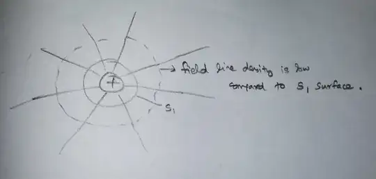

EDIT
To explain electrostatic force we developed the idea of electric field and field lines. So, F=Eq. When we draw field lines around a positive charge, the density of lines gives us an idea of electric field intensity around the charge.
Electrostatic force is related to field intensity. Also, field intensity at a point is represented by density of field lines. Density depends on surroundings. This gives me an idea that, force at any point depends on surrounding (supporting my question , "is force just along the line joining the two charges?" ) , as field intensity depends on density, which needs the idea of surrounding region. I know the idea of density of lines related to field intensity is just from pictorically representing field lines. But I feel that this idea can support my question, but not sure.

The electrostatic force or the electric field (force per unit of charge) is the force the charges feel. It's not the net force of many forces, since it's the only force.
A force field is a function from the space variables (points in space) which returns the force (in the form of a vector) at that point. The other points in space, where the charge isn't, aren't feeling any "force", nor those "forces" aren't having any effect in the charge. The field is just a construction for representing the (net, if there is more than 1 charge) electric force at each point.

prolyx
  • 1,439
I think, in a classical context, the confusion occurs in the first drawing of your second photograph. The field depicted is due to both charges and that field represents the direction of the electrostatic forces which a third charge experiences. For each of both individual charges, the field lines emanating from the individual charges (so the field lines which are there in the presence of only one electric charge) determine how the other charge will move. Each separate charge, when considered a point particle, will not experience the infinity of symmetric forces you depict if the density of field lines goes wild. This would yield an infinite force. Of course, if the charges have a spatial extension, as in your drawing, the charges are influenced by more than one field line. In fact by an infinite number of them. In the case of the two charged blobs you depicted one has to integrate over the charge densities to find the force between the blobs.
The density of field lines is in fact ill-defined. In every volume of space, there is an infinity of field lines. So its quite useless to state that the nearer a charge is approached, the "more infinite" the field line density grows. Electric flux, on the contrary, is well defined and its density at various points is related to the electric field.
The pattern of field lines in your first drawing on the second photograph is the pattern a third charge encounters when moving relative to these two. The two charged particles themselves don't follow these field lines (without a third charge in play), just as a single charge doesn't move in the field lines produced by itself (even though the sum of all forces ending "on" the charge is zero in this case).
The infinity of different field lines at the point where each charge finds itself doesn't act on the charge producing these field lines. Moreover, this infinity doesn't actually exist at the point where the charge finds itself. There is a shell (with a radius that approaches zero) around the charge on which the flux density is infinite (infinite electrostatic force). The field lines don't intersect, as would be the case if the lines end up at the charge (only one field line can exist at every point in space).
So the field produced by two charges tells you how a third charge will move. And just so, the field of one point-charge tells you how a second charge will move in it (and vice-versa). So don't confuse the field produced by two charges with the fields in which the two charges move (which are one-charge-fields).
So the point charges don't experience symmetric forces in the way you depicted as this would yield an infinite force towards the other charge after summing them all. A finite result is only obtained if all forces (or the charge itself) approach zero, which isn't the case.
Of course, I can misunderstand what you mean. It could be that you mean to say that there is a finite amount of symmetric forces, leading to a finite net force, but then obvious new problems arise. It might also be that you mean that there is an infinite amount of forces that have all a magnitude that approaches zero, leading to a finite net force (see the answer involving tiny threads of elastic "material").

All the other answers seem to focus on the force aspect of this problem. Let me try to address your question in a slightly different way.
Electrodynamics is distinct from classical mechanics in many ways, one of which being that it is a field theory: the (electric) field here is the fundamental object. Indeed, the forces on charged objects should be thought of as resulting from those objects' interactions with the field, given by Coulomb's law, $$\mathbf{F} = q\mathbf{E} + q\mathbf{v}\times \mathbf{B}.$$
A nice way to think about your setup with two point particles is this. Every charged particle interacts with the electromagnetic field in its immediate vicinity, whether that field is generated by parallel plates, another particle, or other external currents. When you fix a positive charge in space, it generates an electric field $$\mathbf{E} = \frac{q\hat{\mathbf{r}}}{4\pi\epsilon_0 r^2},$$ which permeates all space (except for the location of the charge, a subtlety we currently ignore). We know that charged particles interact with any electromagnetic field, so a negatively-charged object, sensing this field in its vicinity, will be pulled along the field lines towards the positive charge. Notice that so far, the electric field seenby the negative charge is radially outwards and spherically-symmetric.
Do not confound this with the dipole electric field, which has those curved field lines you drew. That field is what a third charged particle will see as it moves in the vicinity of the two particles. Indeed, the dipole field you drew is precisely the superposition of two spherically-symmetric electric fields, and so the force exerted on the third particle can be thought of as a vector sum of the forces exerted on the third particle by the other charges.
