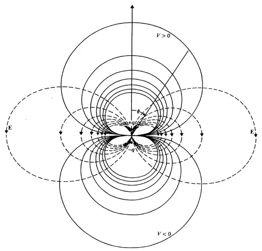

The E field of a dipole falls of as $\frac{1}{r^3}$, and atoms are generally close to spherically symmetric so that theres almost no field outside them.
The E field of an electric dipole is well documented:
