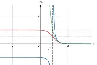

The average number of particles at the $\varepsilon_r$ energy level in the Bose-Einstein statistics is given by
$$\bar n_r=\frac{1}{e^{\beta(\varepsilon_r-\mu)}-1}$$
I wonder what the significance that the chemical potential $\mu$ has in these statistics. I see that $\varepsilon_r$ must be bigger than $\mu$, since $n_r$ would diverge at $\varepsilon_r=\mu$ and would take negative values for $\varepsilon_r<\mu$. This doesn't happen in the Fermi-Dirac nor Maxwell-Boltzman statistics (plotted in red and green in the picture, next to next).
I understand that, as bosons don't follow the Pauli exclusion principle, they tend to fill first the lowest energy levels, but what is the meaning of the divergence and negative values of $n_r$ at $\varepsilon_r\leq\mu$? What is the role of the chemical potential?
