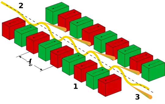

In some sense, this is indeed the working principle of modern accelarator-based x-ray sources. There, an electron beam (the charge in the question) is accelarated to high velocities and then "shaken" by so-called wigglers or undulators. The latter are essentially alternating magnets. See this picture from wikipedia:
This is indeed also the principle used at free-electron lasers and x-ray free electron lasers, so it can be used to produce very high frequency radiation. The record (as of April 2020) currently seems to be a photon energy of 25 keV corresponding to $\lambda = 0.05~\mathrm{nm}$ wavelength or a frequency of
$$f = \frac{c}{\lambda} = 6.0 \cdot 10^{18} \mathrm{Hz} \,.$$
Note, however, that the wavelength is not equal to the shaking wavelength here. Instead, for small wiggler strength parameter (see wiki), the wavelength is given by
$$\lambda_\mathrm{radiation} = \frac{\lambda_\mathrm{shaking}}{2\gamma^2} \,,$$
where $\gamma$ is the Lorentz factor of the accelerated electrons. So essentially the radiation wavelength is proportional to the shaking wavelength, but you have an additional Lorentz boost factor due to relativistic effects.
So a fast charge is shaken here to produce light of very high radiation. Not sure if that qualifies as "shaking" as defined by the OP though.
