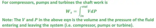

In this shaft work formula shown above, is the sign of the shaft work positive due to work being done by system on fluid OR work being by fluid on system?

The formula result for the shaft work
$$W_\mathrm{s} = \int_\mathrm{in}^\mathrm{out}{V \cdot \mathrm{d}p}$$
  • is positive for compressors or pumps ($p_\mathrm{in} \lt p_\mathrm{out}$ ), where the work is system input
  • is negative for turbines ($p_\mathrm{in} \gt p_\mathrm{out}$ ), where work is the system output.
Therefore the used convention is the latter.

Turbine work is work done by the system (by the working fluid). Compressor and pump work is done on the system (on the working fluid).
Insofar as which is positive and which is negative is concerned, it depend on what version of the first law is used for an open system. For one version, turbine work is considered positive and compressor and pump work is considered negative. For the other version, it it is the reverse.
But both versions are consistent in that for each version work done by the fluid decreases the energy of the fluid and work done on the fluid increases the energy of the fluid.
Bottom line: IMO. Whether the work is considered positive or negative is unimportant as long as work done by the fluid reduces the energy of the fluid and work done on the fluid increases the energy of the fluid.
