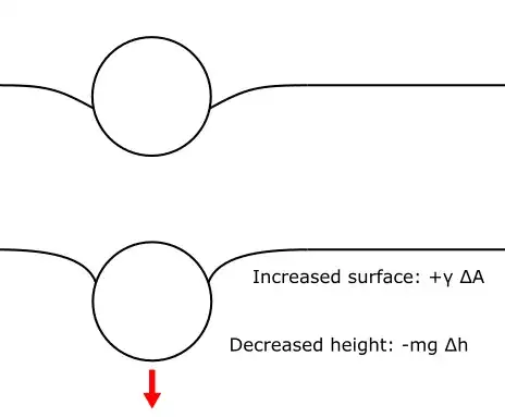

There is an energetic cost to having a surface between two interfaces. Increasing the surface by $\Delta$ costs $\Delta W=\gamma \Delta A$, where $\gamma$ is the surface tension. We can imagine displacing our floating needle downward a little bit by $\Delta h$. This will cause the potential energy to decrease by $-mg\Delta h^\dagger$, but the surface of the water gets larger, which increases the energy by $\gamma \Delta A$. For water, the surface tension is particularly high and it is possible for the increase in surface energy to overpower the energy gain by sinking the needle. In that case, the needle will float.
$\dagger$ Technically, $m$ is here the mass of the ball minus the mass of the displace volume of water.
