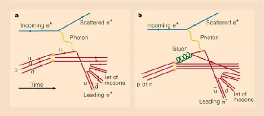

The probability to form only a proton is 0%, as you just can't have 3 free quarks around. It doesn't really makes sense to talk about it, as it cannot exist. You can make a "lone" quark that is not exactly free. This is done by deep inelastic scattering, were a scattering electron scatters off a proton:
Here, in the proton rest frame, the electron energy is much greater than the proton mass, and to 1st order, the exchanged virtual photon has a wavelength much smaller than the proton size (1 fm). It can resolve individual valence and sea quarks, and knock them out of the proton.
The problem is, as it leaves the proton, the energy of the QCD field becomes large enough to produce a $q\bar q$, with the antiquark glomming onto the quark to make a meson. (A similar process called "sparking of the vacuum" can occur in ultra strong electric fields, where it is energetically favorable to make an $e^+e^-$ pair to lower the field energy by more than $2m_ec^2$).
So, imagine simultaneously knocking out 3 quarks from various nucleons in a nucleus, all with the same (or similar) 3-momenta and location, which would give you your free-ish quarks. (Note: the probability of achieving this in the lab in effectively 0). Those quarks will from a proton, because baryon number is conserved. There will also be showers of meson (c.f., the jet).
