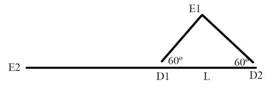

Edit I've simplified the setup of the experiment and added a drawing. Experiment
t0: E1 emits light in all directions.
t1: This synchronizes the clocks on detectors D1 and D2.
t2: After synchronization, E2 emits a laser beam towards both detectors.
t3: D1 detects the light first and stops its timer.
t4: D2 detects the light second and stops its timer.
One-way speed of light: c = L / (t4-t3)
The Einstein synchronization convention really is just a convention. Nothing prevents you from synchronizing clocks in some other way. Einstein synchronization just happens to usually be more convenient than alternatives when it's possible (which it isn't always).
Lisle's paper effectively defines a time coordinate $t' = t + (1{-}ε)|x|/c$ for some small $ε>0$. With respect to this time coordinate, the speed of light moving toward the origin (i.e. the Earth) is $-dx/dt' = c/ε \gg c$.
You can't falsify this because it's just a mathematical substitution of variables. It's not clear to me what setup you intend for your one-way speed of light measurement, but whatever it is, you can do the exercise of assigning standard inertial spacetime coordinates to every event in the problem, then calculating $t'$ for each event, and then describing in words what this "means". You'll find that everything conspires to give you a result consistent with an isotropic speed of light, even though the speed is "really" anisotropic. You can also "explain" GPS signals, Rømer's experiment, or anything else in Lisle's coordinates. This proves nothing except the internal consistency of algebra and calculus.
Lisle claims that God used that convention to synchronize the biblical creation: in other words, that the universe began on the surface $t'=t_0\approx -6000\text{ yr}$. That's an actual physical claim that I suppose is falsifiable in principle. But the synchronization conventions that we (as opposed to God) use have no physical significance. There's no evidence that anything in nature ever depends on whether events are simultaneous by any convention at all.

This second answer is specifically for the setup represented with the diagram in the question.
Experiment
E1, E2, D1 and D2 are co-moving with each other.
The triangle E1, D1, D2 is of course intended as an equilateral triangle.
As we know: when the propagation of light is represented in a coordinate system that is co-moving with this setup then light emitted from E1 in effect defines simultaneity for that coordinate system. In terms of co-moving representation: light emitted from E1 reaches D1 and D2 simultaneously.
The same proceedings can with equal validity be represented in any coordinate system of the overall equivalence class of inertial coordinate systems.
When represented in any coordinate system not co-moving with this setup the plane of simultaneity comes out differently.
Generalizing:
In all cases where the representation can with equal validity be represented in terms of any member of the equivalence class of inertial coordinate systems: relativity of simultaneity is inescapable.
That is to say: the question of whether one-way measurement of the speed of light is possible is regarded as interconnected with the question of whether there is any way to avoid relativity of simultaneity.
Any setup that does not eliminate relativity of simultaneity is regarded as not being a one-way measurement of the speed of light.

Regarding your proposed experiment: it seems to me that you have already assumed that light travels with the same speed in any direction when you synchronize the clocks of D1 and D2 in the way you propose. If the one-way speed of light is not isotropic, then it would take different amounts of time for the beam to travel the distance E1-D1 compared to E1-D2, and the clocks of D1 and D2 would then not be synchronized in the way that I think you want.
