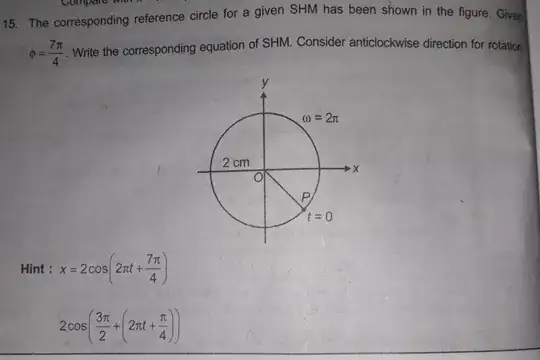

When to use $x = A \sin (wt + p)$ and $x = A \cos (wt+p)$ during Simple Harmonic motion when we start our clock when the object is between mean position and extreme position ?
I have been trying to study, and I know that when we start from extreme position, we use cosine, and sine for mean, but what if we start in between?
I know that both have a phase difference of 90 ' , but , if an initial phase is given , how to determine that it is p for x = A sin (wt + p) or = A cos (wt+p).
You can explain with the help of this problem. Thank you. enter image description here

This is an initial value problem. The general solutions to harmonic motion is either $$x(t)=A\sin(\omega t+\phi)$$ or $$x(t)=A\cos(\omega t+\phi)$$ or even $$x(t)=A\cos\omega t+B\sin\omega t$$ They are all equivalent they just give different values of $\phi, A$ or $B$. Pick the one you like most. To determine these constants you need initial values (you can also call them boundary conditions). You have two unknowns so you need two initial conditions. An example would be knowing that at $t=0$ the oscillator has position $x(0)=x_0$ and velocity $v(0)=v_0$. When you consider an extreme position you still have two initial values you just have $v(0)=0$. If we pick the $A\sin(\omega t+\phi)$ solution this gives the conditions $$\cases{A\sin\phi=x_0\\A\omega\cos\phi=v_0}$$ which in principle allows you to solve for $\phi$ and $A$. Does this answer your question?
I realise I might have misread your question a bit. The equations that accompany the figure should be \begin{align} x(t)&=A\cos(\omega t+\phi)\\ y(t)&=A\sin(\omega t+\phi) \end{align} Why? At $t=0$ this describes a point at angle $\phi$: \begin{align} x(0)&=A\cos(\phi)\\ y(0)&=A\sin(\phi) \end{align} This follows from some trigonomotetry
unit cirlce
If I understand correctly in the question they define $\phi$ as the angle the points makes at $t=0$ but I'm not sure since that would require more context.
