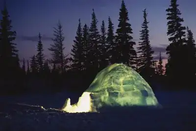

You can see on the image an igloo illuminated by fire.
