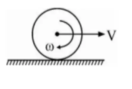

The point of contact is being displaced along the surface. This would imply that some work is being done on the surface by friction. But there is no work done by friction on the ground. Please provide a detailed explanation.Body moving on a rough surface (May or may not be pure rolling)
See my post here: Where does a torque-invoking force belong in work energy theorem? (instead of tension, think friction).
Essentially, there is work done while translating and work done due to the rotation. These works cancel.
