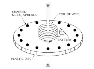

Consider a plastic disc which has equally charged metal spheres fixed in position at its rim. A current carrying coil is placed around the center of the disc as shown.
Disc arrangement
Now if the current is suddenly switched off, the magnetic field produced by the coil will drop to zero and thus there will be a change in magnetic flux through the plastic disc. This will cause circular electric field lines to form at the rim of the disc which will exert a net torque on those charges causing the disc to rotate.

If the coil causes the angular momentum of the disk to change, then there is an equal and opposite change in angular momentum on the coil (assuming no outside forces or torques apply). If the coil is rigidly mounted, then there is a torque on whatever it's mounted to.
