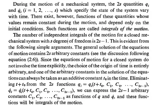

In Landau's mechanics, one can read in chap 6 about the energy:
Landau page 17
What is it you do not understand?
