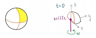

Is it even possible to calculate moment of inertia of strange objects like 1/4 of a sphere?
1/4 of a sphere

Of course you can! You "simply" have to use the definition of moment of inertia. The difficult is doing the right integration. Remember to specificate always respect which axis are you calculating the moment of inertia to. In the picture it's shown. Also, should be specified if the rigid body has an uniform density. Let assume it is. In this case you should use the Huygens-Steiner Theorem: first calculate the moment of inertia respect the axis that crosses the CM (that is the smallest moment of inertia you can calculate of every rigid body, and it's easier to evaluate) and then use the theorem. Sometimes symmetries can be a salvation for the evaluation of the integral. Hope this can be helpful to give you the principal idea.
If you look carefully at the Integral you want to perform, you notice there is no angle dependence. So you can move pieces of you sphere around, as long as r of each individual element stays the same. By using rotations, you can rotate each of the 'quarter' elements of the sphere to exactly match your object. Long story short this means: I(Sphere)=4I(your shape)
