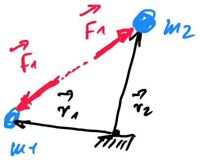

Look at this example the equations of motion Newton second law and third law.
$$m_1\,\vec{\ddot{r}}_1=\vec{F}_1=\frac {G\,m_1\,m_2}{\vec r_1\cdot \vec r_2}\,\vec{\hat e}_{12}$$ $$m_2\,\vec{\ddot{r}}_2=-\vec{F}_1=-\frac {G\,m_1\,m_2}{\vec r_1\cdot \vec r_2}\,\vec{\hat e}_{12}$$
if you add those equations you obtain.
$$m_1\,\vec{\ddot{r}}_1+m_2\,\vec{\ddot{r}}_2=0~\Rightarrow~ m_1\,\vec{\dot{r}}_1+m_2\,\vec{\dot{r}}_2=\text{const.}$$
the center of mass equation is:
$$\vec{\ddot{r}}_{CM}=\frac{m_1\,\vec{\ddot{r}}_1+m_2\,\vec{\ddot{r}}_2}{m_1+m_2}=0~\Rightarrow~\vec{\dot{r}}_{CM}=\text{const.}$$
thus the linear angular momentum at the center of mass is conserved.
due to Emmy Noether theory the Lagrange (or the equations of motion) must be symmetric. if you change $\vec r_1\leftrightarrow \vec r_2$ the equations of motion are the same (symmetry ).
If you map $~\vec r_1\mapsto \vec r_1+\vec u~, ~\vec r_2\mapsto \vec r_2+\vec u~$ where $\vec u~$ is constant you obtain the same result.
thus the condition of symmetry and translation invariance is fulfill by applying Newton second law and third law
