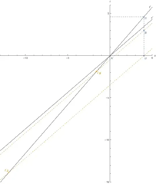

Rule #1 when you can't figure out what's going on in a special relativity problem: draw a spacetime diagram. This is, by far, the best way to understand what's going on in most special relativity paradoxes. If you want to actually understand what's going on with special relativity, rather than simply learning a few counterintuitive formulas, I highly recommend learning about spacetime diagrams. Here's a good set of lecture notes from Stanford about how to construct them and how to interpret them. They're not hard (a high-school student such as yourself should be able to understand them), and they make everything so much clearer.
For your situation, we denote the events as follows:
  • Event $A$: spaceship passes Earth. (We'll assume, for simplicity, that it's zipping past Earth rather than accelerating from rest.)
  • Event $B$: the star collapses into a white dwarf.
  • Event $C$: the spaceship passes the location of the star/white dwarf.
  • Event $D$: the "countdown" until the star's collapse begins. In the Earth's frame, this countdown takes three years.
What we see, when we construct this diagram, is that the events you're concerned about happen in a different order in the spaceship frame. In the Earth's frame, they happen as follows:
  1. The spaceship passes the Earth (Event $A$). Simultaneously, the countdown to the star's collapse begins (Event $D$).
  2. The star collapses (Event $B$.)
  3. The spaceship passes the location of the star, now a white dwarf (Event $C$.)
But in the spaceship's frame, the events happen in the following order:
  1. The countdown to the collapse begins (Event $D$.)
  2. The star collapses into a white dwarf (Event $B$.)
  3. The spaceship passes the Earth (Event $A$.)
  4. The spaceship passes the location of the star, now a white dwarf (Event $C$.)
In the ship's reference frame, the "countdown" to the collapse does in fact take much longer than the journey from the Earth to the star's location. We can see this from the diagram — there's much more distance along the $t'$ axis between $D$ and $B$ than there is between $A$ and $C$. But in the ship's reference frame, the countdown also starts (and ends!) well before the ship passes the Earth. So there's no paradox with events happening "out of order".
