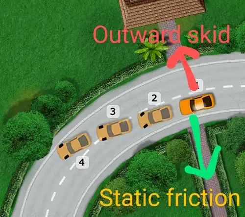

In the above image, it is clear that the car alongwith turning is also going away from the track and this is the point where the static friction comes into existence. This force prevents the outward skid.
However there is a certain limit in the magnitude of this force and after you exceed a certain velocity, you skid away from the track and the static friction is replaced by the kinetic friction.

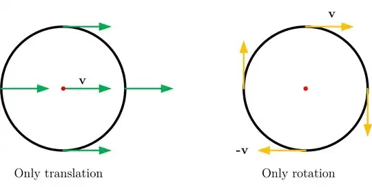

Consider a wheel that is only translating (i.e. no rotation about the center of mass). I have illustrated this below -- the red dot is the center of mass, and notice that every point in this wheel is moving with the same velocity $\vec v$.
Now consider a wheel that is only rotating. Every point on the outer edge of the wheel will have speed $v$ (assuming no slipping).
See the following sketch. The red dot is the center of mass.

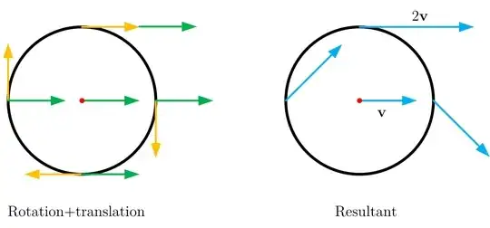

Now, to view the 'full motion,' we can 'add' the rolling motion and the translating motion and get this:
Notice how the velocity of the bottom-most point is zero? That is, the contact point (through which friction would act) is instantaneously at rest!
Since it's not moving wrt the ground, then the friction must be static.
