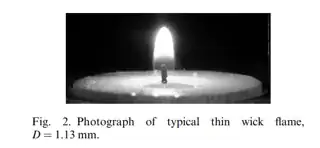

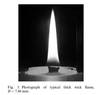

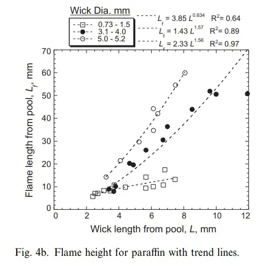

The paper by Sunderland et al. (2011) discusses the characteristics and measurements of candle flame shapes, including an analysis of flame height and width for various wick diameters and lengths. It also touches upon the conditions necessary for sustaining a flame on a candle wick.
enter image description here enter image description here enter image description here enter image description here

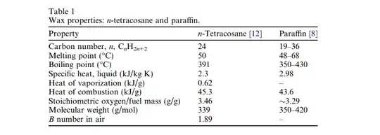

Sunderland, P. B., Quintiere, J. G., Tabaka, G. A., Lian, D., & Chiu, C.-W. (2011). Analysis and measurement of candle flame shapes. Proceedings of the Combustion Institute, 33(2), 2489–2496. doi:10.1016/j.proci.2010.06.095
Here’s a summary of the relevant findings:
Critical Size for Combustion
  1. Wick Diameter and Length:

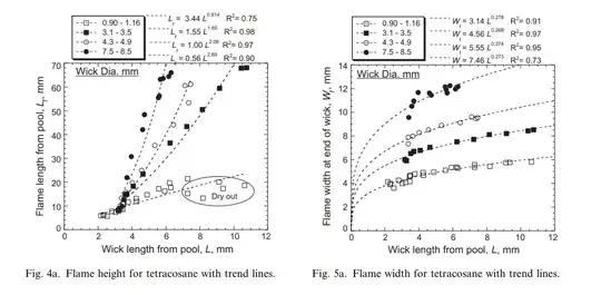

    • The study found that the diameter and length of the wick are critical parameters that influence the flame size and stability. Wicks with diameters ranging from about 1 to 9 mm and lengths from about 2 to 10 mm were tested.
    • The aspect ratio (diameter to length) of the wick plays a significant role in flame attachment and stability. Wicks with aspect ratios between 0.1 and 2 were examined.
  2. Minimum Wick Size:
    • The paper notes that flames might not survive on wicks shorter than about 1 mm. Specifically, it suggests that dry-out, where the flame extinguishes due to insufficient fuel supply, tends to occur for aspect ratios ($D/L$) of less than 0.15.
    • A more precise threshold is given by the equation indicating no flame for $Ra^{1/4} (L/D) < 2$, where $Ra$ is the Rayleigh number based on the wick diameter. This corresponds to a minimum wick diameter of approximately 0.88 mm for sustaining a flame, depending on the aspect ratio.
Modeling and Practical Implications
  1. Flame Height and Width:
    • The height and width of the candle flame were found to be dependent on the wick size and properties of the fuel. The flame height is modeled to be linearly related to the fuel flow rate in laminar flow conditions.
    • The flame width at the top of the wick is related to the heat transfer and burning characteristics of the fuel.
  2. Combustion Characteristics:
    • The study concludes with equations that predict the flame height and width based on wick dimensions and fuel properties. For instance, the normalized flame height is given by: $$ \frac{L_f}{D} = C Ra^{1/4} \left(\frac{L}{D} - 2\right)^n $$ with specific constants for different wax types.
In summary, there is a critical minimum size for the wick to sustain combustion, which is approximately around a diameter of 0.88 mm for typical wick lengths. Wicks below this size may not support a stable flame due to insufficient fuel flow and combustion dynamics. This critical mass for combustion ensures that the wick can maintain the necessary heat and fuel supply to sustain the flame.

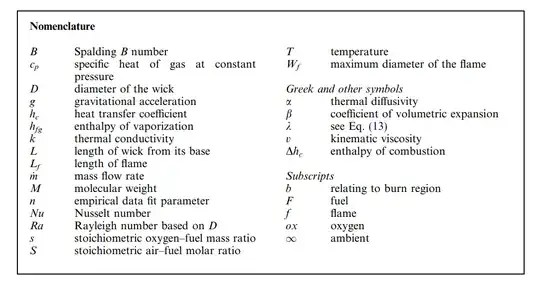

Nomenclature
The paper by Sunderland et al. (2011) develops a model for predicting the flame height and width of a candle flame based on the properties of the wick and the wax. This model can help determine if there is a minimum size for a flame by examining the parameters involved in sustaining a flame.
Model Overview
The model in the paper is based on a combination of empirical observations and theoretical predictions, particularly focusing on the following aspects:

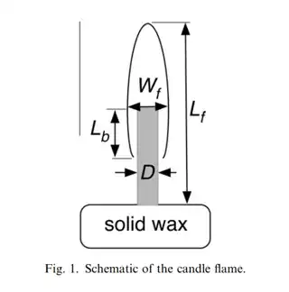

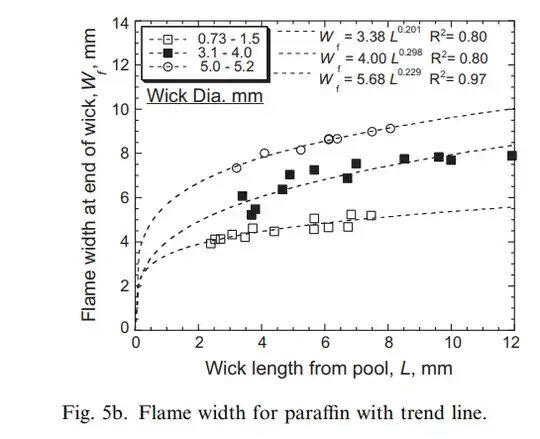

  1. Flame Height: $$ \frac{L_f}{D} = C \left( Ra^{1/4} \left(\frac{L}{D} - 2\right) \right)^n $$ where:
    • $ L_f $ is the flame height.
    • $ D $ is the wick diameter.
    • $ L $ is the wick length.
    • $ Ra $ is the Rayleigh number, defined as $ Ra = \frac{g \beta (T_f - T_\infty) D^3}{\nu \alpha} $.
    • $ C $ and $ n $ are constants derived from empirical data (e.g., $ C $ is 0.526 for tetracosane and 0.470 for paraffin, $ n $ is 0.75 for tetracosane and 0.60 for paraffin).

  2. Flame Width: $$ \frac{W_f}{D} = 2.71 \left(\frac{0.70}{k} \right) $$ where $ k $ is a parameter that depends on the local heat transfer and burning rate per unit length at the top of the wick.

Exploring Minimum Flame Size
To determine if there is a minimum size for a flame using this model, we need to examine the behavior of the flame parameters as the wick diameter and length decrease.
  1. Flame Height and Minimum Wick Size: According to the model, the normalized flame height $ \frac{L_f}{D} $ becomes undefined or non-physical if the term $ Ra^{1/4} \left(\frac{L}{D} - 2\right) $ becomes too small. This implies there is a critical value below which the flame cannot be sustained.
  2. Critical Rayleigh Number: The paper suggests that no flame can be sustained for $ Ra^{1/4} \left(\frac{L}{D} - 2\right) < 2 $. Substituting the expression for $ Ra $: $$ Ra = \frac{g \beta (T_f - T_\infty) D^3}{\nu \alpha} $$ This can be rewritten to find the critical diameter $ D $ and length $ L $: $$ \frac{g \beta (T_f - T_\infty) D^3}{\nu \alpha} \left(\frac{L}{D} - 2\right)^{1/4} < 2 $$ Simplifying, we get: $$ D < \left( \frac{2 \nu \alpha}{g \beta (T_f - T_\infty)} \right)^{1/3} $$
