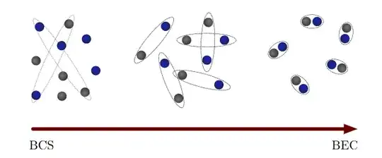

Some pictures in these lecture notes show,
when BEC pairing occurs, two fermions form a molecule
which hints my understanding about BCS pairing and BEC pairing above is not correct. Yet I still cannot imagine how repulsive interaction can result in a molecule.

This is pictorially shown below (picture taken from here) , where the ellipses show the "range" of the pairing and bonds:

In the context of BCS-BEC crossover, your "BEC pairs" would be diatomic molecules formed of two fermions. This molecule behaves like a boson because, in the weak interactions and dilute limit, its size is bigger than the atomic radii so that the fermionic nature of its constituents is not relevant to the scattering dynamics. In other words, you can treat this "pair" as a single particle (molecule) and you can Bose condense them.
The BCS pairs are the Cooper pairs. When the size of the pair spans a much larger area than the atom itself, it becomes impossible to know which other atoms it is paired with. So you do not have clear cut composite systems like the diatomic molecules before. This idea of electrons in Cooper pair is usually oversimplified and leads to confusion. To quote John Bardeen (the 'B' in BCS) himself:

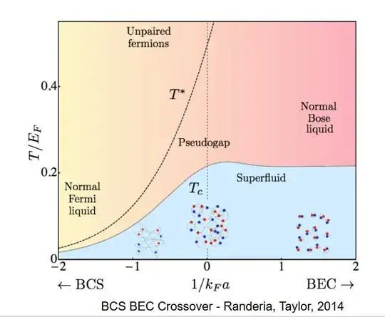

What makes the difference is the spatial extent of the pair (molecule or Cooper) with respect to the inter-pair distance. You could also have a pseudo-BCS/BEC thing with attractive interactions and varying the density alone.
In the case of experimental cold atoms, it just worked out that weak values of positive and negative interaction strengths resulted in a useful phase diagram:
