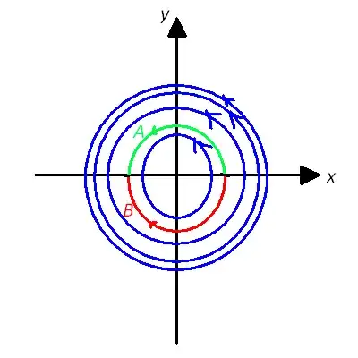

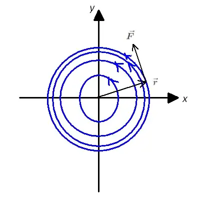

Your conclusions are not correct. Here is a simple counter-example. Consider this force $$\vec{F}=k(x\hat{y}-y\hat{x})$$ where $\hat{x}$ and $\hat{y}$ are the unit-vectors in $x$ and $y$-direction, and $k$ is some constant.
From this definition we see, the magnitude of the force is $F=k\sqrt{x^2+y^2}=kr$, and its direction is at right angle to $\vec{r}=x\hat{x}+y\hat{y}$. So we can visualize this force field like this:
The force circulates the origin in a counter-clockwise sense.
This force clearly satifies your first condition
  1. $\vec{F}$ is a function of only the position, i.e. $\vec{F}=\vec{F}(\vec{r})$
But it is not of the form $\vec{F}=f(r)\hat{r}$.
And this force violates your second condition
  1. The work done by the force is independent of the path between the two point.
To prove this consider the following two paths:
  • Path A (in green): beginning on the right at $(x=R,y=0)$, doing a half circle counterclockwise, to the point on the left $(x=-R,y=0)$.
  • Path B (in red): beginning on the right at $(x=R,y=0)$, doing a half circle clockwise, to the point on the left $(x=-R,y=0)$.
Then the work for path A is (because here $\vec{F}$ is always parallel to $d\vec{r}$) $$W_A=\int \vec{F}(\vec{r}) d\vec{r}=kR\cdot\pi R=\pi k R^2.$$
Then the work for path B is (because here $\vec{F}$ is always antiparallel to $d\vec{r}$) $$W_B=\int \vec{F}(\vec{r}) d\vec{r}=-kR\cdot\pi R=-\pi k R^2.$$
You see, the work is different for the two paths, although the start and end point of the paths are the same.
This is a simple example of a non-conservative force. The non-conservativeness can easily be checked by calculating its curl and finding it is non-zero.
$$\vec{\nabla}\times\vec{F} =\vec{\nabla}\times k(x\hat{y}-y\hat{x}) =2k\hat{z} \ne \vec{0}$$
