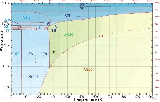

You can have a look at this pressure/temperature phase diagram of water:
Phase diagram of water
Phase diagram taken from Martin Chaplin's webpage (archived here), under license CC-BY-NC-ND. This webpage is highly recommended, with tons of useful links and articles.
For reference, the diagram shows a point labeled $`` \textbf{E} "$ for fairly standard human conditions, around $25\sideset{^{\circ}}{}{\mathrm{C}} ~ \left(\sim 77\sideset{^{\circ}}{}{\mathrm{F}}\right)$ and normal atmospheric pressure.
The phase boundary between $\color{darkblue}{\textbf{Solid Ih}}$ and $\color{green}{\textbf{Liquid}}$ represents the temperature/pressure combinations at which water coexists between liquid water and solid ice. This boundary shows that the freezing temperature is roughly constant over a large pressure range, from about the triple-point (where solid, liquid, and vapor can coexist) and up to a pressure of about $200 \, \mathrm{MPa} .$

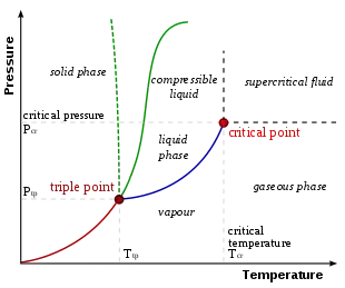

If you decrease the pressure, the freezing point of water will increase ever so slightly. From 0° C at 1 atm pressure it will increase up to 0.01° C at 0.006 atm. This is the triple point of water. At pressures below this, water will never be liquid. It will change directly between solid and gas phase (sublimation). The temperature for this phase change, the sublimation point, will decrease as the pressure is further decreased.
Water phase diagram
