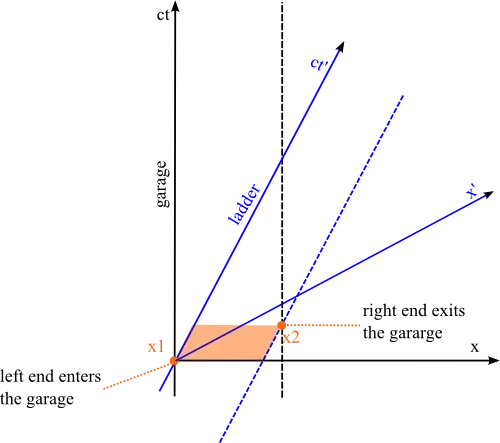

If you have started from the constant speed of light and arrived at space time diagrams, you can see our confusion about measuring the length of a relativistic ladder.
All observers agree on the proper length of the ladder. That is the length in a frame where the ladder is at rest. To get the length, you measure the $x$ coordinates of the ends and subtract.
In a moving frame, an observer measures a contracted length. He can then do a calculation to figure out the proper length. Why does he need to? The ends have to be measured at the same time, this is where it gets tricky.
In a spacetime diagram, the $x$ axis is the line where $t = 0$. In a classical spacetime diagram, all observers use the black $x$ axis. There is no problem measuring the ends at the same time. But at relativistic speeds, the line where $t = 0$ is just as motion dependent as the line where $x = 0$. We have a glacier world like confusion. In the garage, you measure the position of the head and the foot of the ladder at the same time on the black $x$ axis. In the ladder's rest frame, you measure them at the same time on the blue $x$ axis. We have two different events where the head of the ladder is at the same time as the foot.
The head and foot of the ladder follow world lines. Time flows in each world line. But there is no universal way of matching up times in different world lines. It is motion dependent, just like matching up same places is motion dependent. Time is very different than we think.
To calculate the proper length, you need to figure out the blue $x$ coordinate when the head's world line crosses the blue $x$ axis. Part of the calculation is to figure out the black $x$ and $t$ coordinates. And part is to understand that if you drew the $1$ meter point on the blue $x$ axis, it would not be where you would expect from looking at the black $1$ meter point.
The point is that the garage frame does not measure the proper length because the head position is measured earlier that the blue frame foot. The head hasn't traveled far enough yet. This makes the length shorter.
So why does it matter? Isn't the black frame idea of same time just as good as the blue frame? Yes, the events where the head and foot really are simultaneous in the black frame. And the ladder really is shorter in the black frame.
This is why it is useful to make a 4D spacetime and create a metric for it. The metric calculates the universal proper length of the ladder. The calculation takes both $x$ and $t$.
It is a little like measuring the length of the ladder from $x$ coordinates while it is laying on the ground vs leaning on a wall. The shorter $x$ coordinate separation is correct, but it doesn't represent the length of the ladder.
