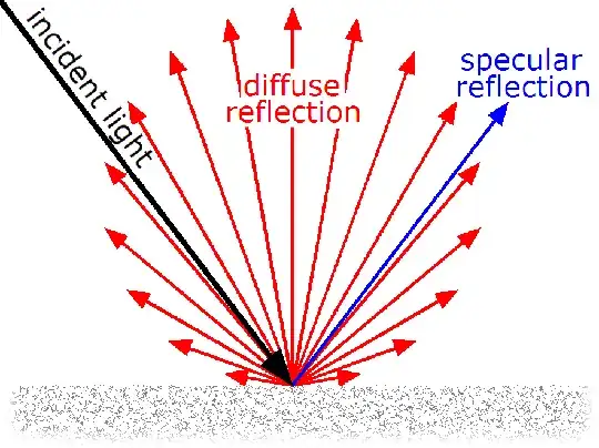

Diffuse reflection:
Diffuse reflection is the reflection of light or other waves or particles from a surface such that a ray incident on the surface is scattered at many angles rather than at just one angle as in the case of specular reflection.
Specular reflection is described as:
Specular reflection, or regular reflection, is the mirror-like reflection of waves, such as light, from a surface.

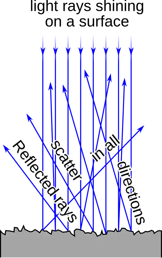

  1. Diffuse (book)
https://en.wikipedia.org/wiki/Diffuse_reflection
In the case of diffuse reflection, in your example the book, the surface might be non-absorbing (plaster, marble) or absorbing (like a normal book cover).
In your case, the book has a surface that on the micro level is diffusely reflecting most of the incident photons, but it does absorb (and re-emit) a considerable portion of the incident photons too.
So the reason the book is the answer is that that is the only one that besides reflecting (diffusely) most photons, it does absorb and re-emit a considerable portion of photons too.
