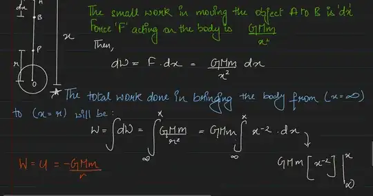

My second doubt was in the derivation of the expression:
$\mathbf U = \frac{-GMm}{r}$
Derivation
  1. Why are we bringing the point mass from infinity to $\mathbf (x = r)$
  2. What's with the negative sign?
  3. Who's work done are we talking about here?
Another thing, Why are we supposed to move the object without an acceleration? Is that even possible?!
