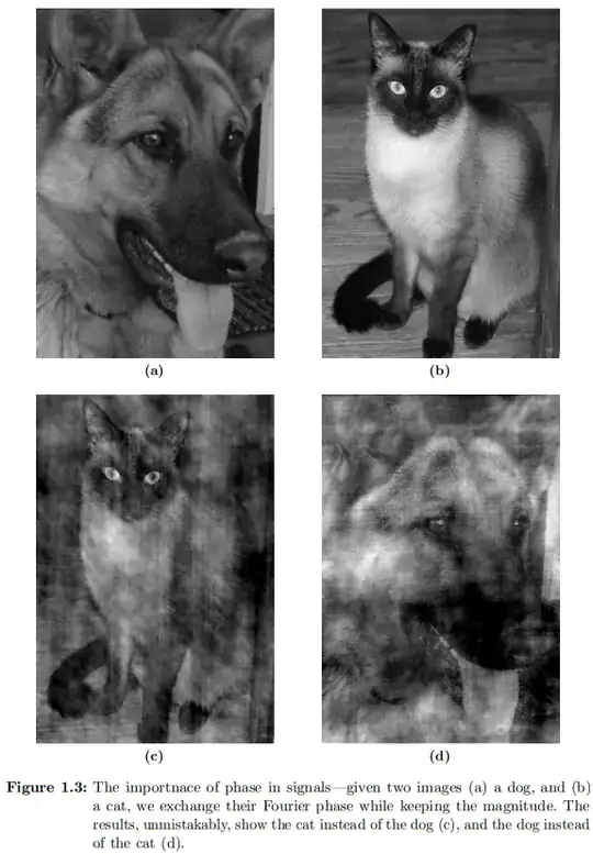

Most of the answers so far are inaccurate or wrong (I will explain why below). The answer is that it is not possible to deblur an image because photos and videos record only the amplitude of a light field and not the phase. A light field is characterized by amplitude and phase (and polarization, but that's unimportant here), but the phase is typically more important. This is dramatically illustrated by the following figure, taken from this paper:
Swapping the phase of two images.
Without getting too much into the details, what the author has done is passed two images through a lens and swapped the phases. The image formed from "dog amplitude + cat phase" (c) looks unmistakably like a cat, and the image formed from "cat amplitude + dog phase" (d) looks like a dog, which shows that it is the phase which stores most of the information in the light field here.
When you take a picture, you record only the amplitude. If your image is not in the focal plane, then the lost phase information is almost unrecoverable, and your eye cannot refocus the image.
Note: I said above that the lost phase information is "almost" unrecoverable. There actually are techniques to recover this information, known as phase retrieval, but they are hard. This is an area of active research. The human eye and brain are not generally capable of doing this algorithmic task. Deblurring algorithms can be thought of as heuristic approaches to this problem which are adequate in special cases.
A few comments about why other answers are incomplete or incorrect:
  • Deblurring is not simply deconvolution. A blurry image can be thought of as a sharp image which has been convolved with a point spread function and then had its phase thrown away. Deconvolution is easy (and can be done by eyes via focusing and by brains in a variety of ways); phase retrieval is hard and generally can't be done by animals.
  • This issue has nothing at all to do with binocular vision. The same considerations apply if you have one eye closed.
  • This issue also has nothing to do with other sources of blur (e.g. aberration). The OP considers blur from defocusing, which is purely a matter of phase loss.
One other answer that is correct is that of @benrg, who approaches this question from the perspective of geometric optics. Phase information in wave optics corresponds to the direction of rays in geometric optics, and the fact that pictures do not record phase information is equivalent to saying that they do not record the direction of rays. The wave optics description that I've given in this answer is "more fundamental" than the geometric optics description, but they are both true, valid explanations of why you cannot refocus a blurry image.
