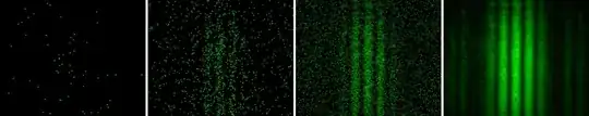

First lets look at a clear experiment, single photons at a time:
Single-photon camera recording of photons from a double slit illuminated by very weak laser light. Left to right: single frame, superposition of 200, 1’000, and 500’000 frames.
The points show the footprint of a particle, a single photon. The accumulation shows an interference pattern which, analyzed shows a wave of frequency equal to the $hν$ of the photons in the beam.
Is there any solution of the wave equation which explains this behavior?
Sure, the quantum mechanical wave function for the solution of the scattering problem "photon + two slits a given width a given distance apart". The wave equation is not the solution of classical Maxwell equations, but of a quantized form and it gives the probability distribution seen in the last frames.
