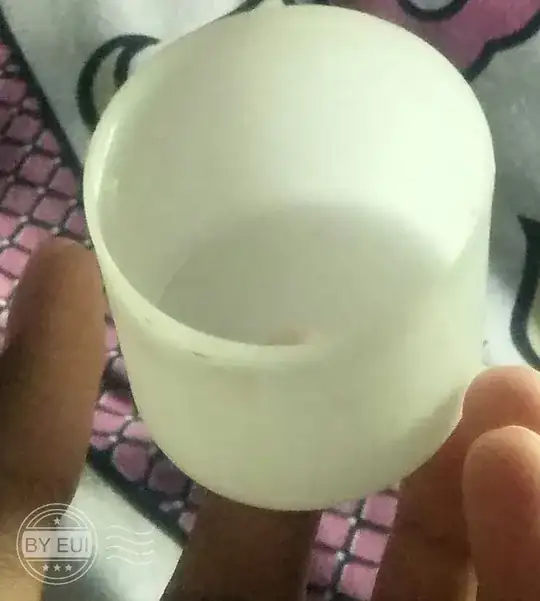

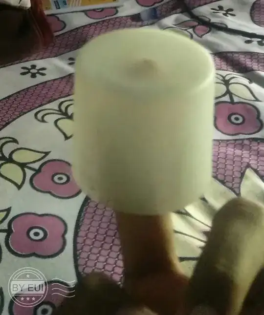

If I try to handle a tumbler or cup on my fingertip (as shown in fig), it is quite hard to do so (and the cup falls most often).
And when I did the same experiment but this time the cup is upside down (as shown in fig), it was quite stable and I could handle it easily.
In both the cases, the normal force as well as the weight of that cup is the same but in first case it falls down and in the other it is stable.
I guess that it is falling because of some torque but why is there no torque when it is upside down.
What is the reason behind this?

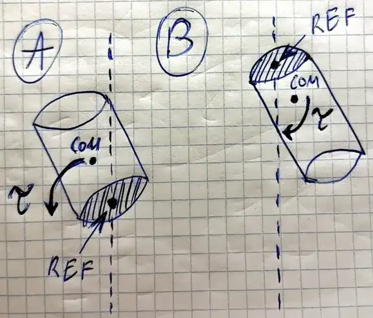

Take a look at this picture of a cup slightly out-of-balance :
In case (A), generated torque is directed out of your reference axis and in case (B) - towards your reference axis. So in case A), you need to compensate out of balance movement with your finger contra-movement. But in case B), torque assists you and makes balancing for yourself, so that you need minuscule additional efforts.

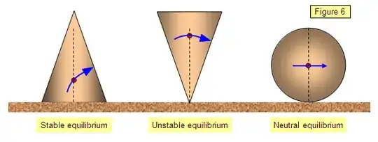

12
Image courtesy google.
I could not manage a better picture than this one.
EXPLANATION
This is because when the cup you hold normally on one finger is in unstable equilibrium and mild deviations from the vertical line can cause it to fall. But there can be a case when you can manage it to be one one finger. Due to centre of mass of cup being above a decent height(even a mild deviation results in its falling.

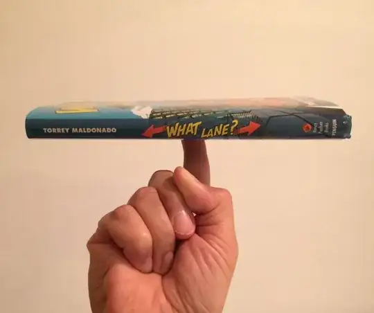

You might have done the task of balancing book on one finger and spinning it or just balancing it.
Isn't that task easier?
You just need to find the equilibrium point and tada!
This is easier because the height of centre of mass above your point of contact is very small. Thus making it easier to keep it straight(sweet intution without using the name of torque).(and don't forget the friction there)

When the cup is upright gravity provides a torque by a force acting on its center of mass which is above your finger. Small perturbations will cause rotation about the point of contact and it rotates away from its original position. It's an unstable equilibrium and it's kind of like balancing a pencil on your fingertips.
When it's upside down it's a stable equilibrium and any perturbations would be restored back to its original position with the help of gravity. Kind of like a pendulum.
